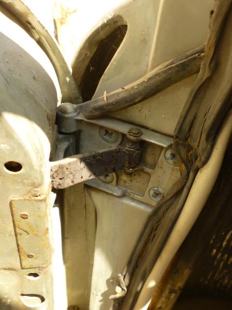

Here is one of the plates installed on my 59 Ghia

Thanks again Loren!! I'll have to search for another pair. That is just 2 that i turned for photos
PostPosted: Sat Dec 23, 2023 12:23 am    Post subject: Re: What's this Ghia part and Where does it go? Reply with quote
Loren wrote:
Those little plates go on the doors and cover the ends of the hinges. I believe 60 was the last year to use them. You should have two per door.
My '66 has them and indeed they're covers for the hinge ends as you say.

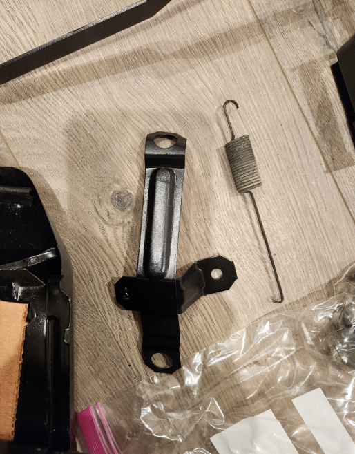

Part came with doghouse tinware set, doesn't look like hoover bit:
Posts: 71336
PostPosted: Mon May 06, 2024 10:12 pm    Post subject: Re: What's this Ghia part and Where does it go? Reply with quote
It looks like a spark plug wire bracket from a Type 3 but a little bent up

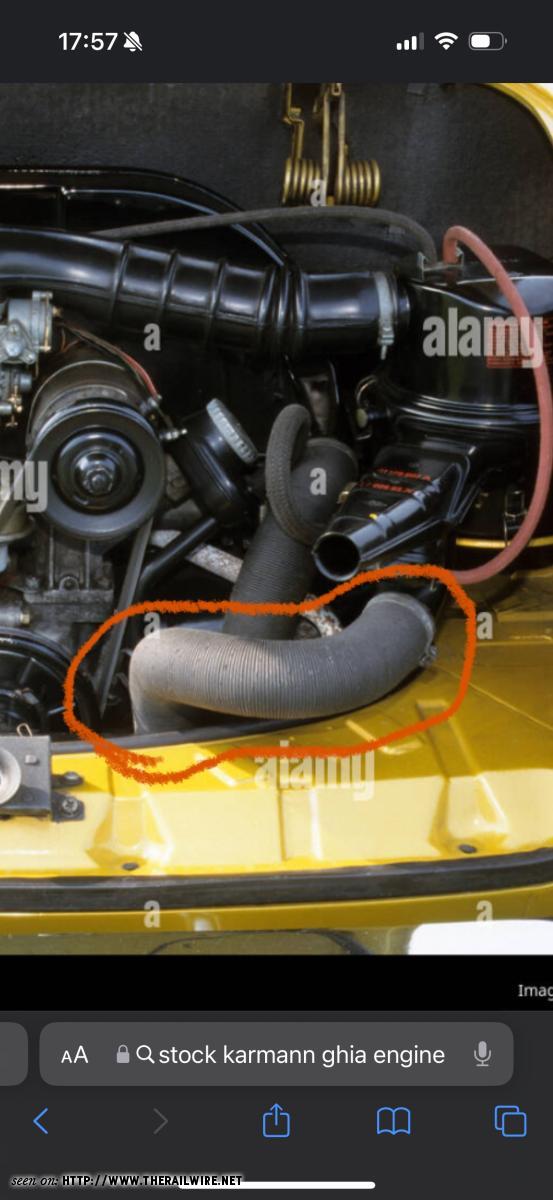

Hey all.
What’s this hose for? I’m looking at a car which has a port for it on the engine but the hose is not there.
Thanks!

PostPosted: Sun Aug 25, 2024 3:18 pm    Post subject: Re: What's this Ghia part and Where does it go? Reply with quote
Should have a tube underneath that will suck warm air from under the 1-2 cylinders.
Part number 113-129-511. D or E

PostPosted: Sun Aug 25, 2024 3:37 pm    Post subject: Re: What's this Ghia part and Where does it go? Reply with quote
Thanks so much for the reply.
Where does it send the warm air, and what doesn’t work if it’s missing?
Edit: looks like it’s a pre-heating tube. Sends warm air to the air cleaner to preheat the air being drawn in. Does that sound right?
Edit: and then i found this!!!
https://www.thesamba.com/vw/forum/viewtopic.php?p=10112848&sid=e3f62337669b497851e2300df5fa3daf
Thanks for giving me a direction to go.

PostPosted: Sun Aug 25, 2024 5:51 pm    Post subject: Re: What's this Ghia part and Where does it go? Reply with quote
OK, you found it. However yours would use a bigger tube than the one in the 66 thread.
