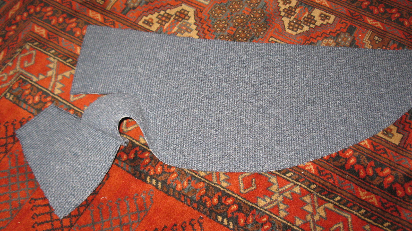

PostPosted: Mon Dec 12, 2011 6:32 am    Post subject: Reply with quote
Hi Guys
Not so much "where" but "how" does it go...
I'm pretty sure this bit of carpet goes over the rear wheel arch in a cabriolet but I can't seem to get it to line up over hump and against the firewall. What's that slot for? and how does that sewn on bit figure?
Does anyone have a suggestion about how to line it up?
Nicholas

PostPosted: Wed Dec 14, 2011 2:16 pm    Post subject: Reply with quote
Obviously it would sense that the staight part would be at the bottom of the hump, the split towards the back wall...and im guessing it wont fit there correctly...
Have you tried calling the maker of your carpet kit? Wish I could be more help.

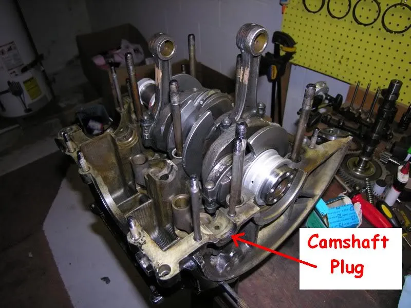

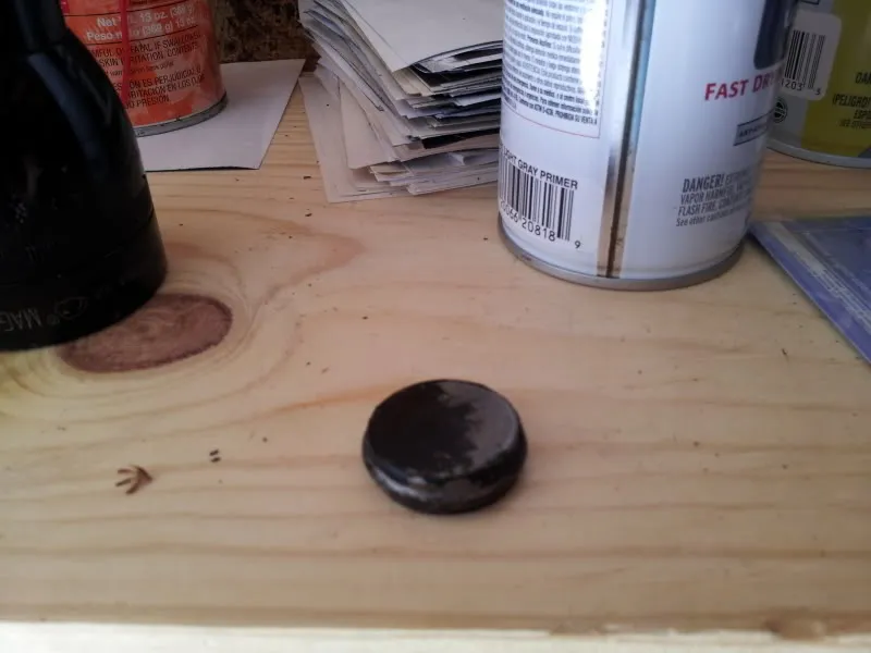

I have a 69 ghia and I'm opened up the motor i bought to figure out all the things i need to replace. Everything is perfect, but this thing popped out once we opened up the actual case. Its a 1600cc dual port engine.
Here is a pic of it, Hopefully someone can guide us on where it goes.
When it fell out, only thing left was the case and in the case, the rods, cam, crank, but no other components.

PostPosted: Sun Jun 24, 2012 11:22 am    Post subject: Reply with quote
That is the cam plug. It seals the cam hole on the flywheel end of the case.

PostPosted: Sun Jun 24, 2012 10:41 pm    Post subject: Reply with quote
thanks altema!! so on the cam where you have the gear aswlel it goes on opposite side of the cam where the opening is, to just cap off?

PostPosted: Mon Jun 25, 2012 1:28 am    Post subject: Reply with quote
That is correct. The raised edge of the plug fits in the groove of the case with the flat side facing out.

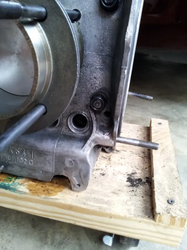

I'm stuck again guys, I'm putting the motor back together (seems to be such a pain getting the freaking crank/cam to sit perfect and we finally got it all done and put the pistons/cylinders and all in. We realize that there's a hole and I'm PRAYING i don't have to open the case to put something through this hole. It says in the book that it must be tightened first, but we don't have it..?
the hole to the right closest to the flywheel
ghia-13
Joined: June 24, 2012
Posts: 12
ghia-13 is offline
PostPosted: Sat Jun 30, 2012 8:48 pm    Post subject: Reply with quote
nvmd we figured it out Smile now we're stuck wondering how it fits to put the distributor gear into the engine. theres a dot on it that we think we need to line up somehow hoping someone knows:)

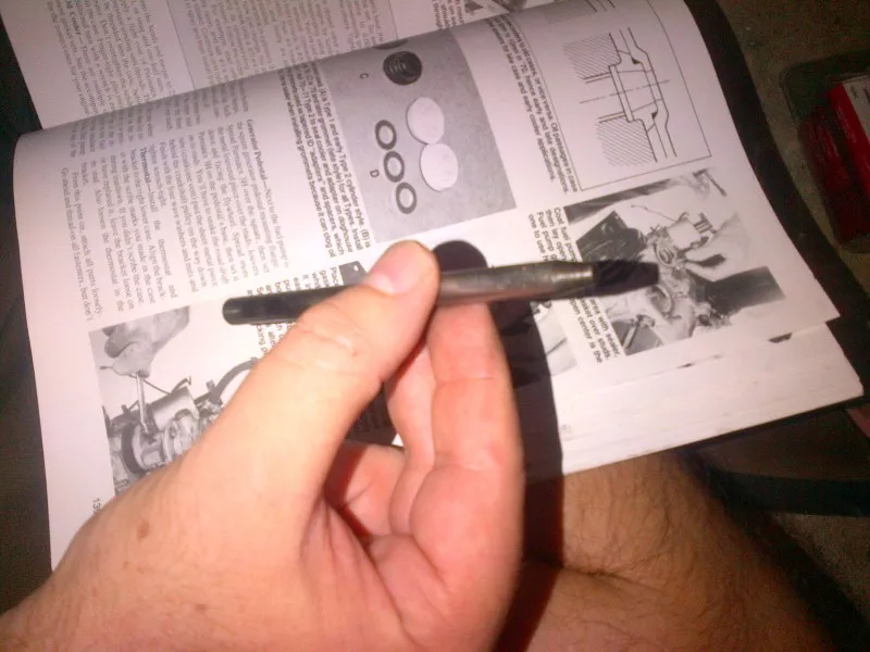

Alrighty guys finally back at it and should have the motor fully done by tomorrow.... This is the metal rod that goes in with the fuel pump. We don't remember if it goes in with the point end towards the motor or towards the pump. The two books we have to assist us covers up exactly where we'd need to see in the image.. and the writing doesn't mention that detail. Hope one of you know Smile Thanks in advance!
Posts: 71336
PostPosted: Fri Aug 31, 2012 10:55 pm    Post subject: Reply with quote
Pointy end toward the engine.
Not the best example pic but here

PostPosted: Sat Sep 01, 2012 8:32 am    Post subject: Reply with quote
Thanks! Just out of curiosity, how did yours bend and brake the plastic??
arnold.mike1976
Joined: January 08, 2012
Posts: 1
Location: HALLSVILLE, TX
arnold.mike1976 is offline
PostPosted: Thu Oct 04, 2012 7:32 am    Post subject: Reply with quote
I had that happen to mine too the guy at Oak Hill Automotive "The Bug Shop" said the wrong push rod was installed with the fuel pump I had. I replaced the push rod and now it runs great. It's nice to have people that know the Classic VW's.

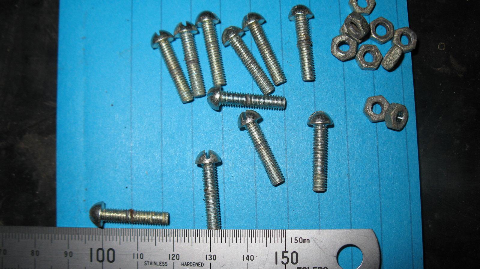

My memory fails me. Does anyone have a suggestion here these screws and nuts come from? There are 11 of them although it would be unsurprising if any are lost. They were off my '66 cabriolet and removed early in the project. I bagged them and when they came back from the electroplaters the labelled bag was a different one. Crying or Very sad
