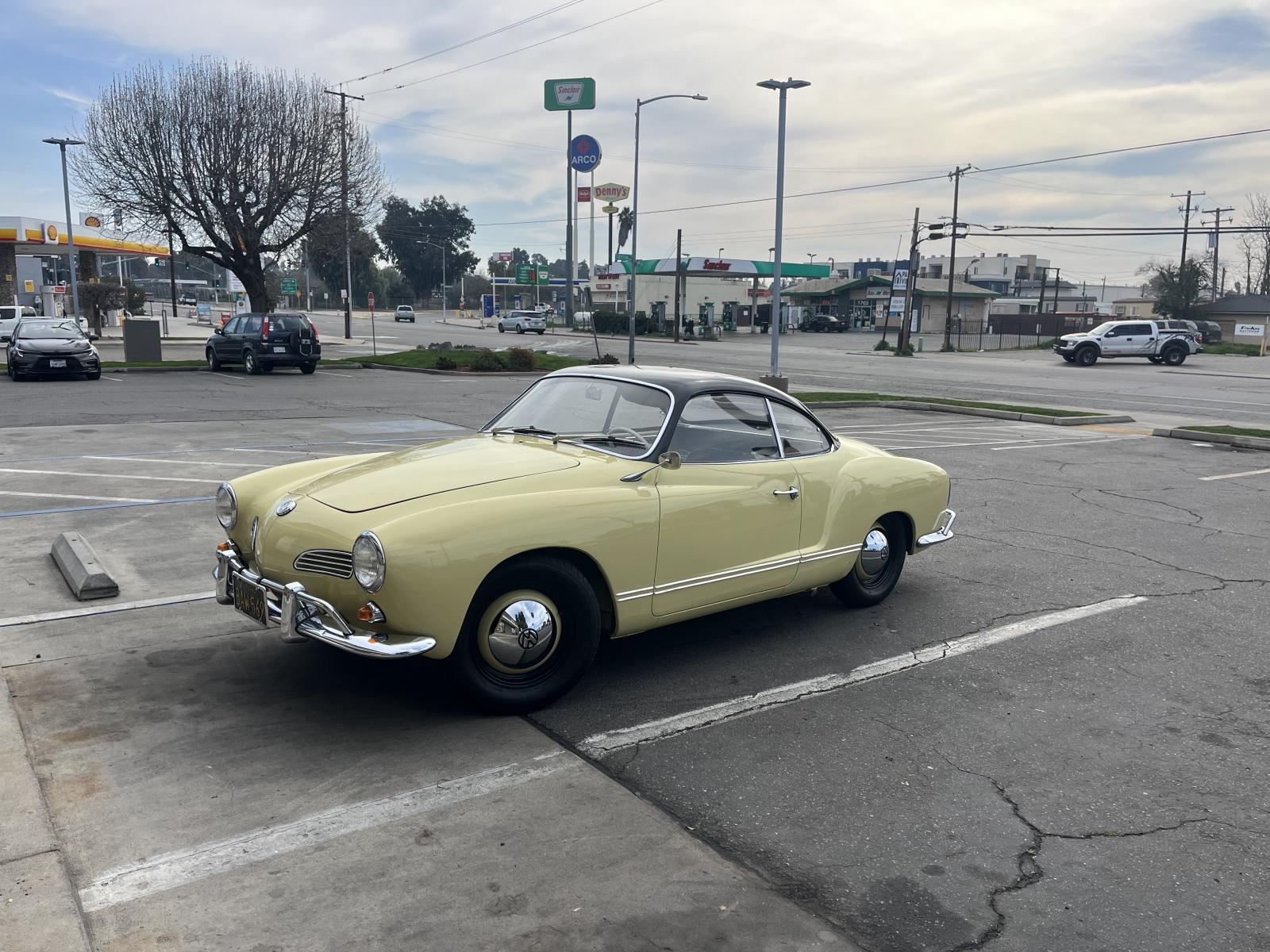

PostPosted: Wed Apr 30, 2025 9:22 pm    Post subject: Re: Karmann Ghia – Essential Guides for Beginners & Experts. Reply with quote
63 ghia. I had a front wheel bearing go out. Ordered new bearings from Wolfsburg. They are roller tapered pin bearings. My old bearings are ball bearing. Inner and outer. Does this matter. Most. Mail order places supply tapered bearings. Does anyone know why there are two types ( ball and tapered pin bearings)? And can I change to roller tapered bearing on the same axil that had ball bearings. ???
