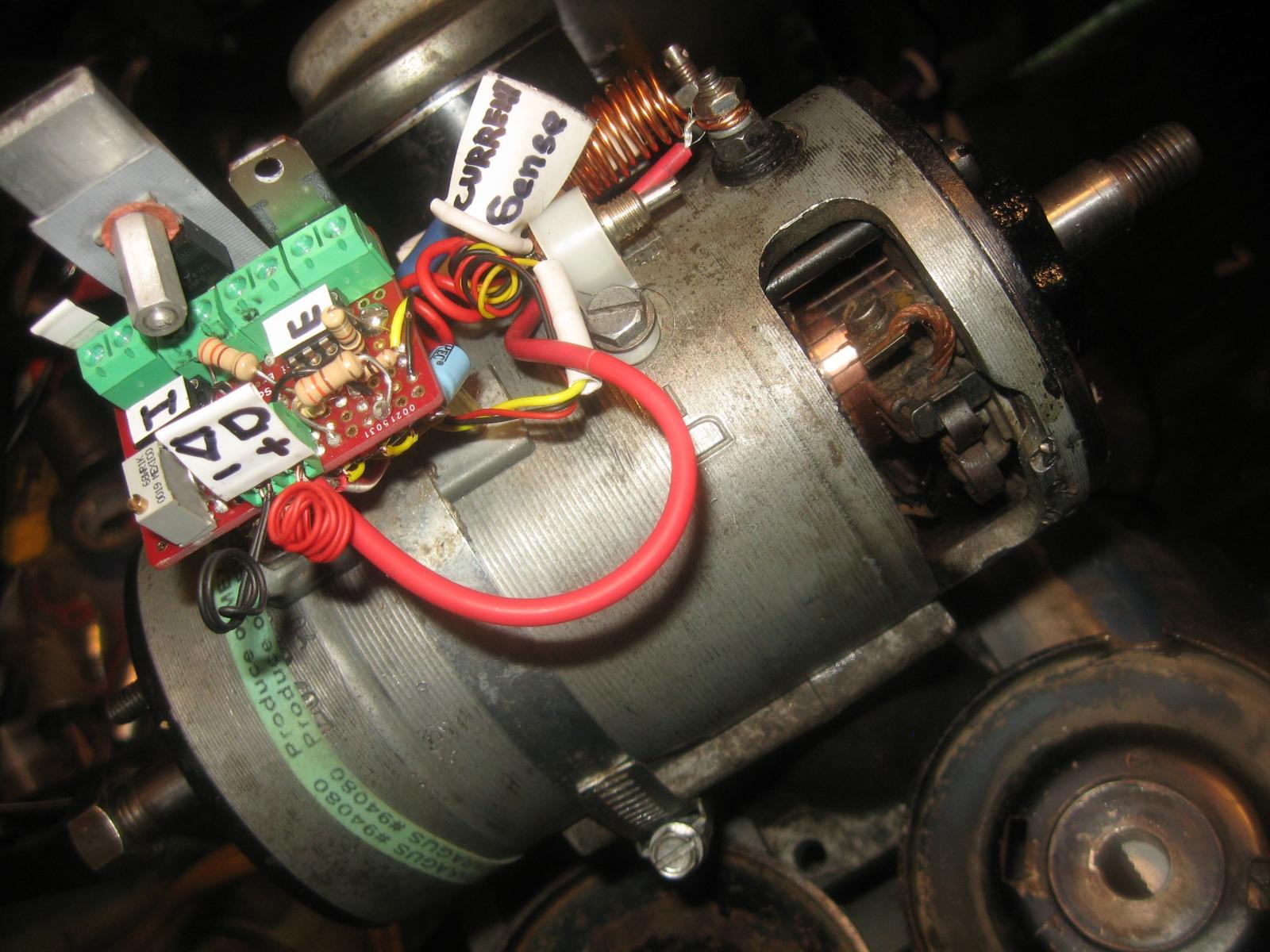

I have a working prototype:

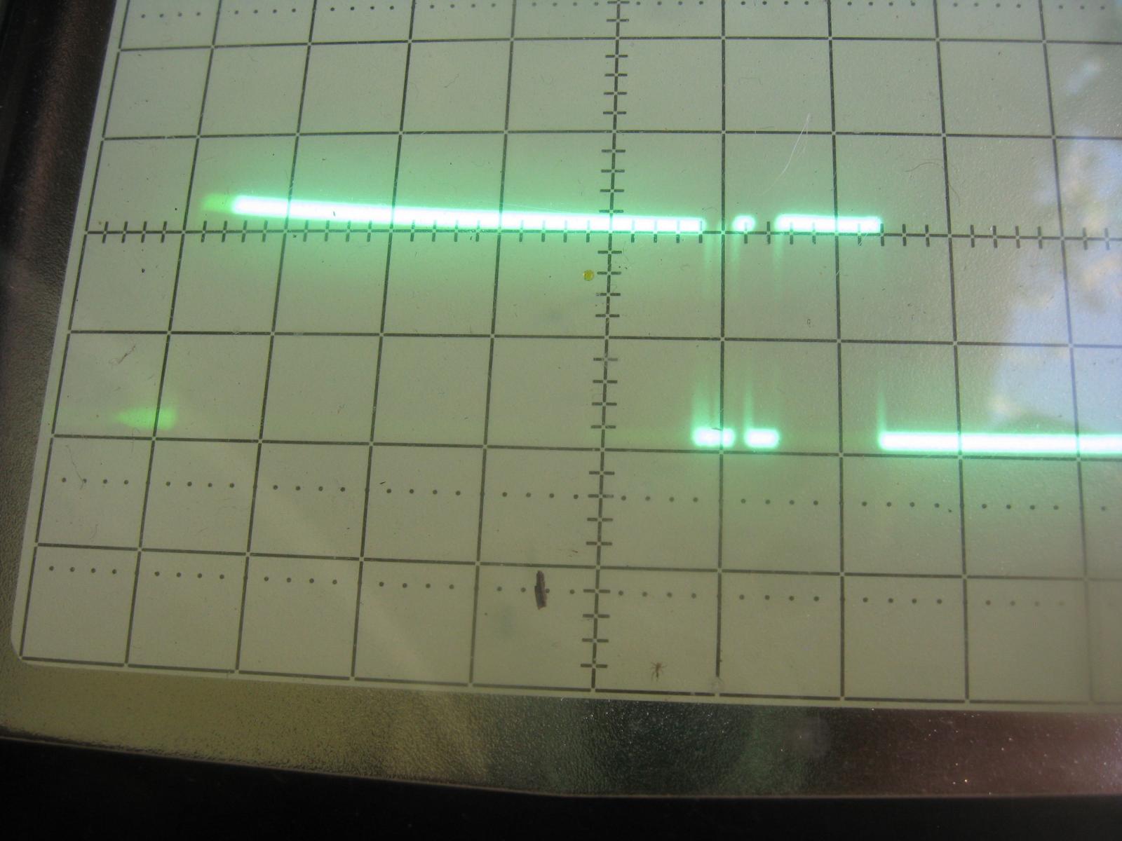

The electronic regulator pulses a MOSFET with a signal to power the generators field. Here Hi is charge, Lo is not charging. The wave form will vary in time hi to achieve the set output voltage . Generator output Levels from 6.3 volts to 10 volts can be set with a turn of the 500 ohm pot.
Scope:

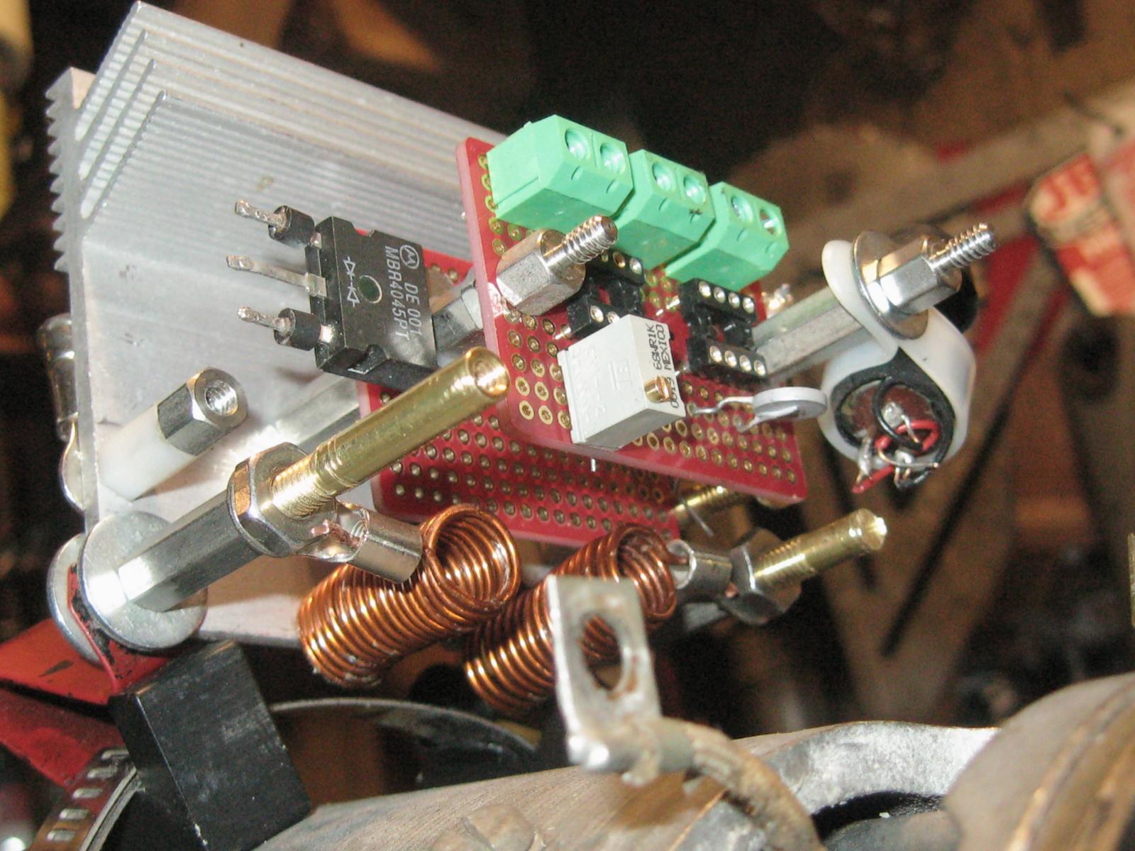

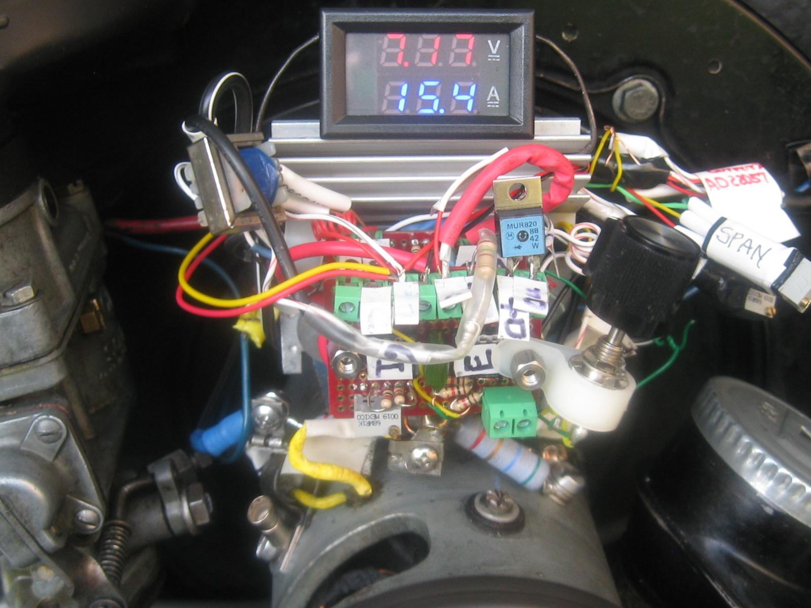

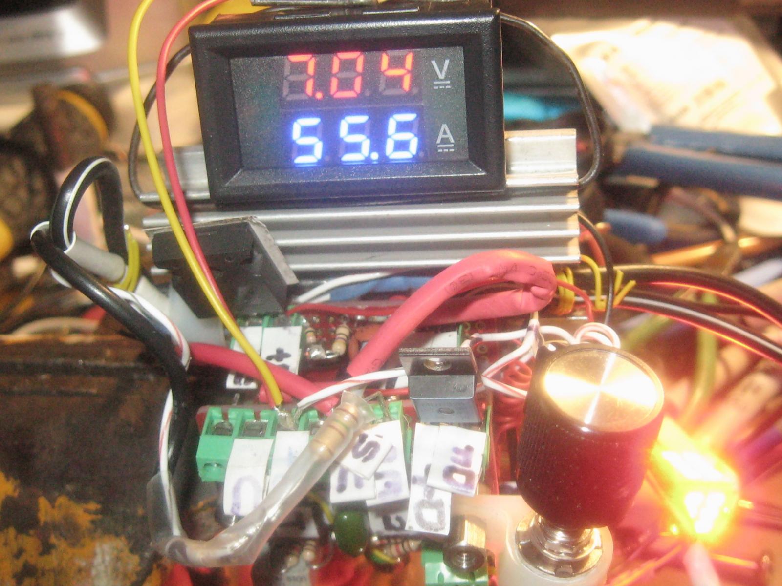

PostPosted: Sun Feb 09, 2020 12:49 pm    Post subject: Re: The New 6 Volt Voltage Regulator Reply with quote
Prototype 2:
Prototype 3:

Nice work there Dan. Way far over my head. But I like that your are doing this at home.
A question! What does the potentiometer (< I don't think I spelled that correctly) do? Does it help to get the generator output set correctly?

Yes it sets the generator output voltage. Adjustable from 6 to 10 volts. Care must be taken to not set it too high. I keep it set it to charge the Optima Battery in the car at 7.0 volts. Also there is a pot on the circuit board for setting the current limit which I set by turning on the hi beam headlights and adjust the voltage up to 8 volts then adjust the current pot to just begin limiting. Then go back to 7 volts.
There is another potentiometer for calibrating and interfacing the el chapo current display. Also made a over voltage alarm circuit that's behind the dash that sounds off if the voltage there goes above 7.4 volts.

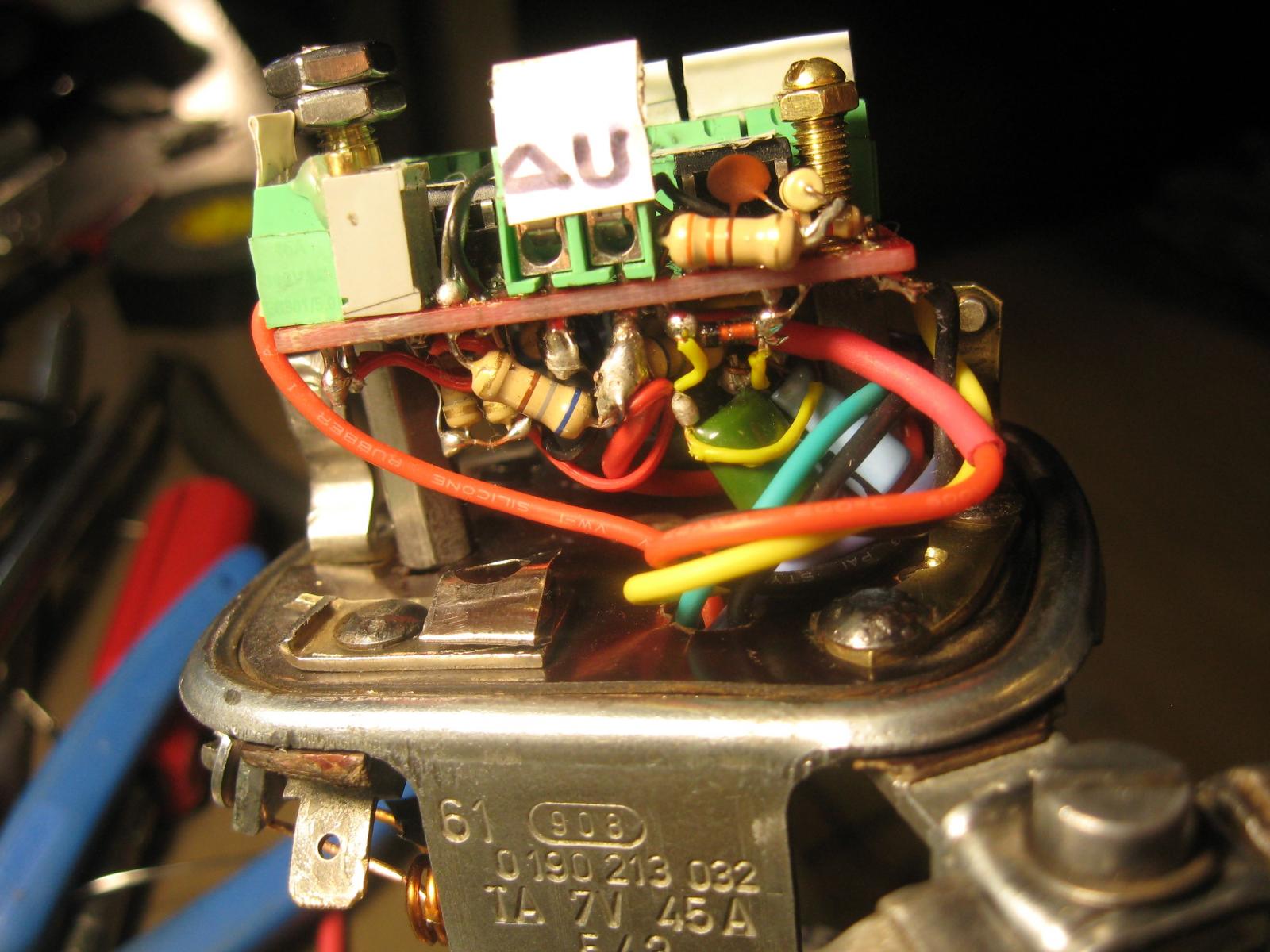

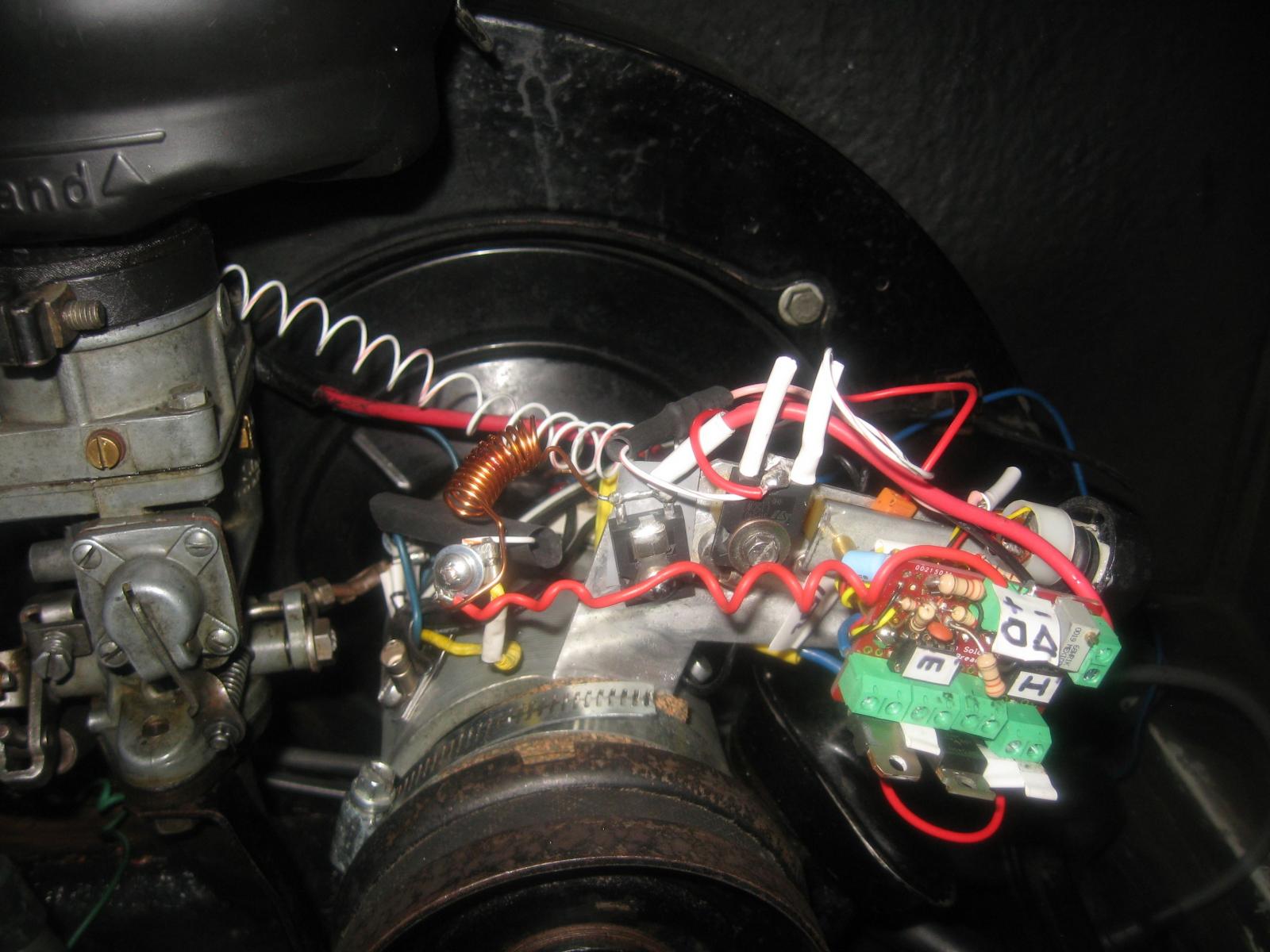

Actually it's a great idea, problems arise like F and DF where F wire needs very low resistance and DF needs high current.
I remember the 6 volt mechanical regulators bolted to the generator in VW Beetles. Not sure about the 6 Volt Bus or. Ghia The 356's mounted very heavy duty Bosch mechanical very nearby on the fire wall.
The circuit board will fit inside an old regulator housing:

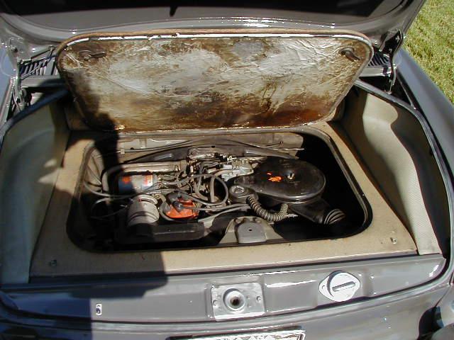

6v type 3 were under the back seat, drivers side

Definitely some places to hide it although the 6 volt Type 3 Generator has it's wiring coming out the closer end to the back seat.
Probably the best place on the bug is inside an original regulator housing. The components that heat up are the cut-out diodes and the shunt used for current regulation Perhaps use 2 cut-out diodes (STPS40L14C) with 2 20Amp Schottky diodes each mounted to the housing or the bottom of a mechanical regulator. The diodes heat at about 7.5 watts per pair under full load. In addition the electronic regulator uses 2 shunts, copper coils that get warm with the headlights on.

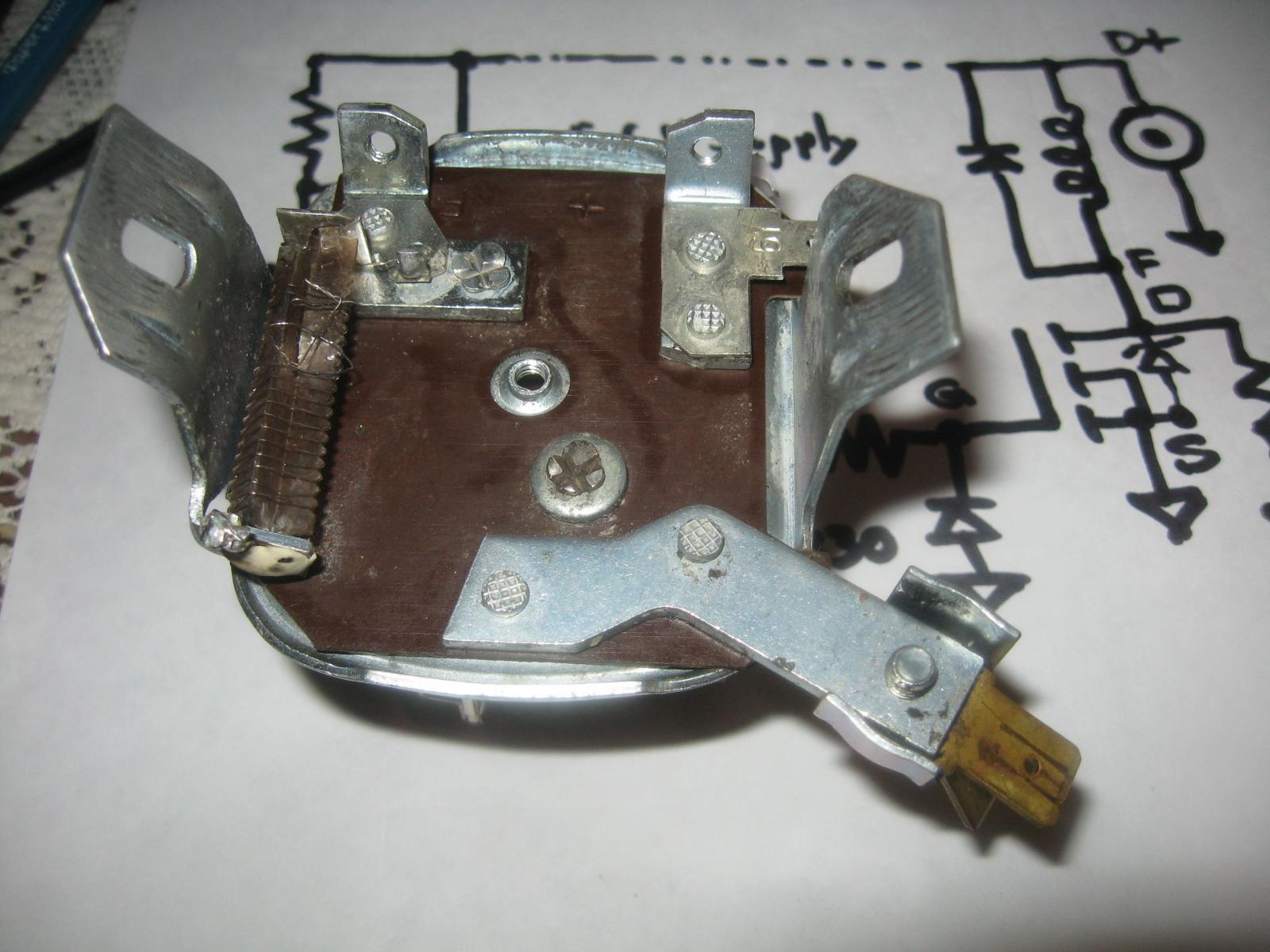

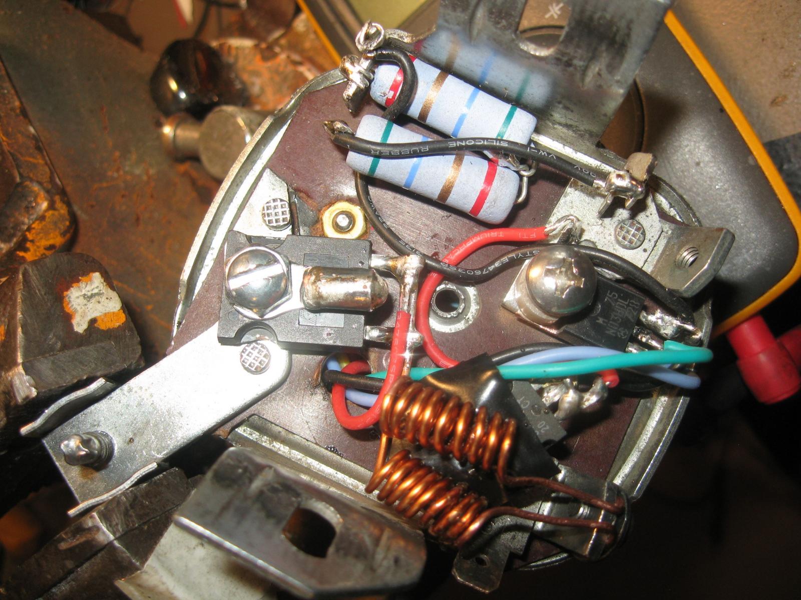

Wow! Might work up front since the battery is there in the 356's. I wonder if the Pre-A's had the same neg ground (bootstrap field to ground to make charge generator) as the later ones and beetles. My 56A had a huge regulator I think it had 3 sets of relays instead of 2 and it was very well behaved.
Well I have been figuring out how to put the electronics into a vw reg housing.
Took my first one I built apart and cut the coils out of a VW 6 Volt Reg and so forth and so on. This is what I came up with. Probably will need better heat sink for the cut-out diodes. I just mounted it on the output arm of the vw reg.
At 50 amps and .34 volts it will be dissipating 17 Watts.

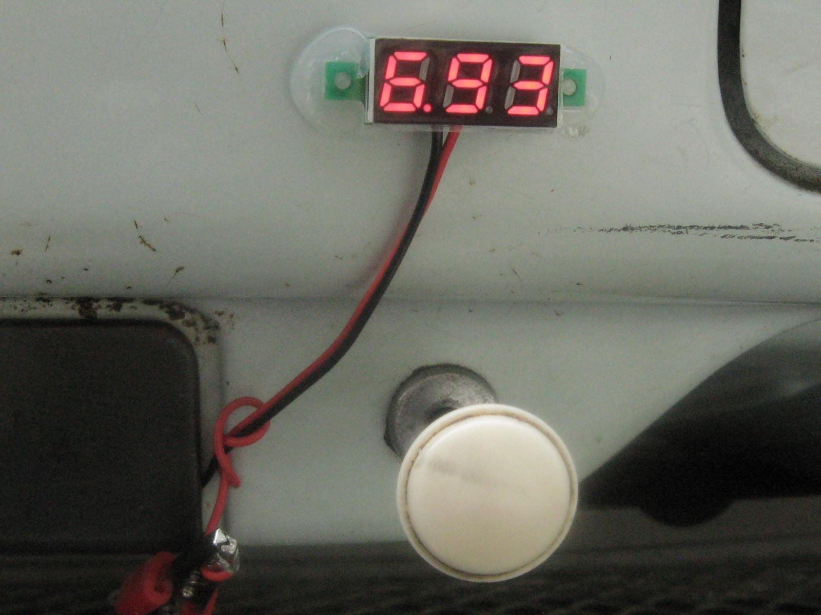

I think it needs to be higher at idle though?
I think the dash light would be on solid at 4-5v (I could be wrong though)
I think my original regulator is around 6v at idle and goes up to a little above 7v at higher revs.

PostPosted: Wed Feb 26, 2020 6:14 pm    Post subject: Re: The New 6 Volt Voltage Regulator Reply with quote
Thanks for the input "EverettB"
In the video the voltage display shows the output voltage at the B+ terminal of the regulator which is .3 volts less than D+ So If this particular generator regulator combo idling produces 3.5 volts at slow idle then a generator lamp (if it had one) would see about 6volts - 3.5volts -.3volts or 2.8volts.(Note no Battery is used for a load just one 6 volt headlamp.)
If With a new generator and a mechanical voltage regulator there is no Gen Lamp on at slow Idle then thats better. Note this video is with my first prototype design. Prototypes 2 and 3 are better. These electronic regulators are adjustable from 6 to over 9 volts with the engine reved and are excellent at holding the set voltage.
