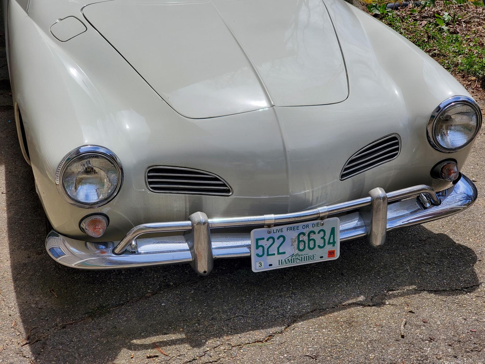

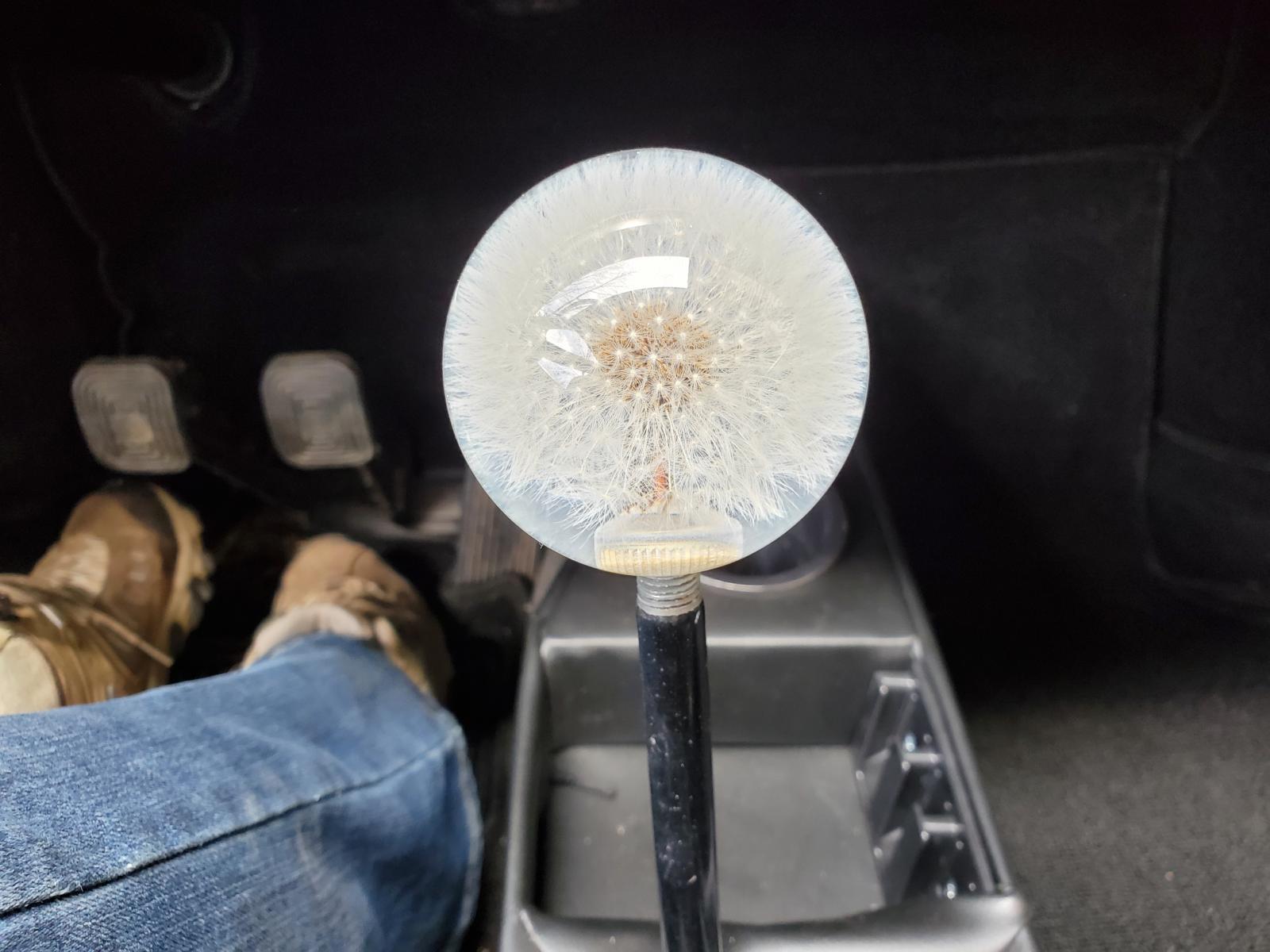

The weather hasn't been terribly cooperative, and I didn't have time to get into anything major or involved this weekend, so I did this:
Need to work on covering up the excess threads and probably should slap some new black paint on the shift stick, but I wanted to add something that made it distinctly mine. Cool
Clear turn signal covers added and temporary amber bulbs in them. I will be switching to LEDs, so hopefully the amber won't show through the lens so much. Acceptable for now. Smile
I also got a "good job cleaning the interior" prize!

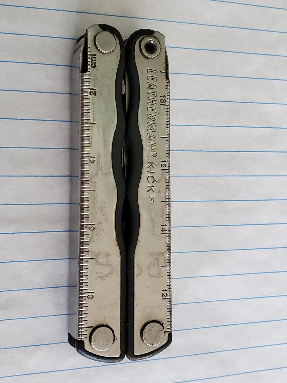

It's in ok shape, but needs a little rust removal and lube. Pretty neat find. Laughing

Very cool shift knob. I have a silly 12 ball because it’s purple.
Since you’re painting the rod anyway I have a few ideas on making the threads go away. The least invasive is to look at 1/2” gas pipes at Lowes or Depot. They normally have a plastic thread protector on the ends which would cover nicely.
Most invasive would be to fill them with bondo.

Ooooo, I like the idea of the thread covers from the gas pipes, I'll look for one today! I'm really not wild about bondo and permanently modifying the stick, so I think option one is the way to go.
The knob that was on it was worn and old and didn't really match anything in the car. I know the dandelion knob is kind of silly, but I like it, and that's all that matters. Laughing

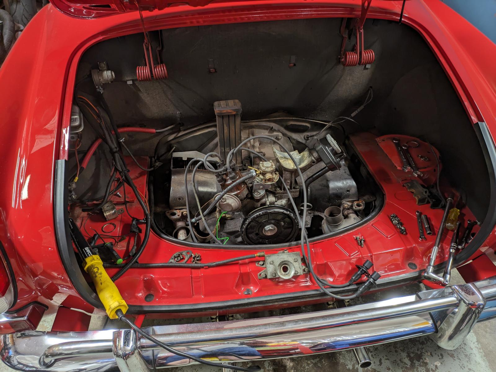

Chasing an engine problem, I found the intake a little loose and one of the single port crush rings not entirely crushed. Also sent the carb out to get rebuilt and he found the mixture screw threads stripped.

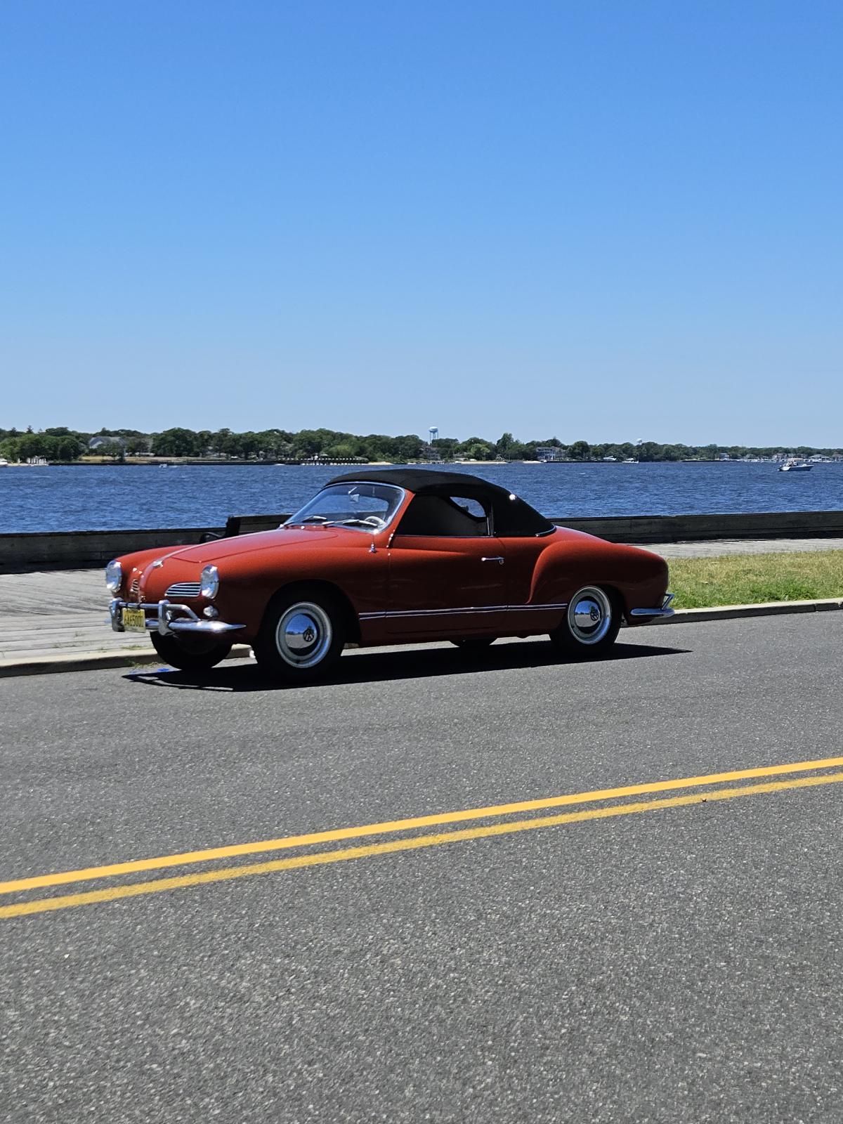

took it for its 1st rides since probably early 2000s

Looks AWESOME!!!! Congrats!

I do admire that colour.

Thats great story that gave you the bug errr Ghia inspiration. I'm not usually a red car person but in our last house we chose to paint the walls an almost identical color as this Ghia!!

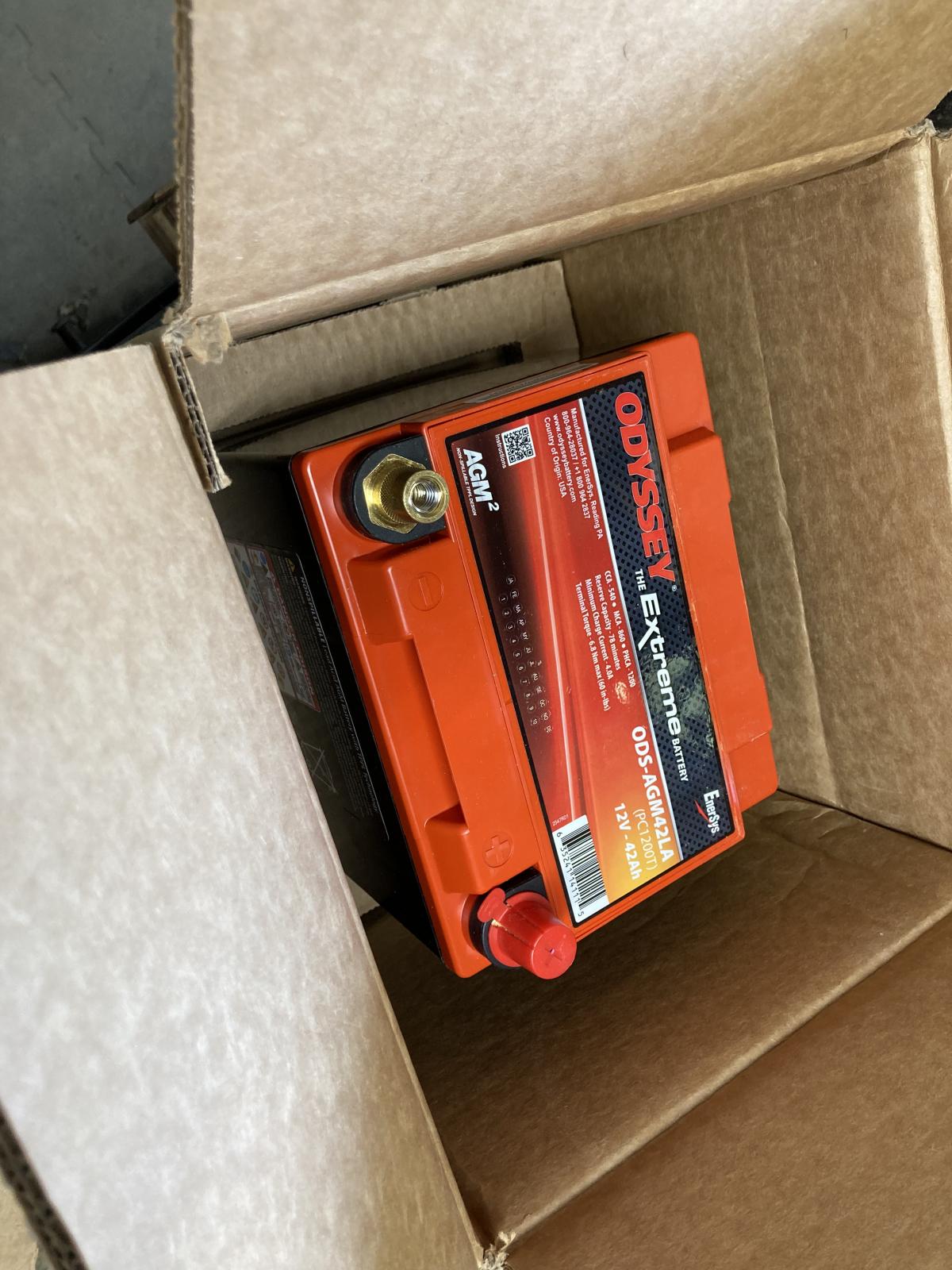

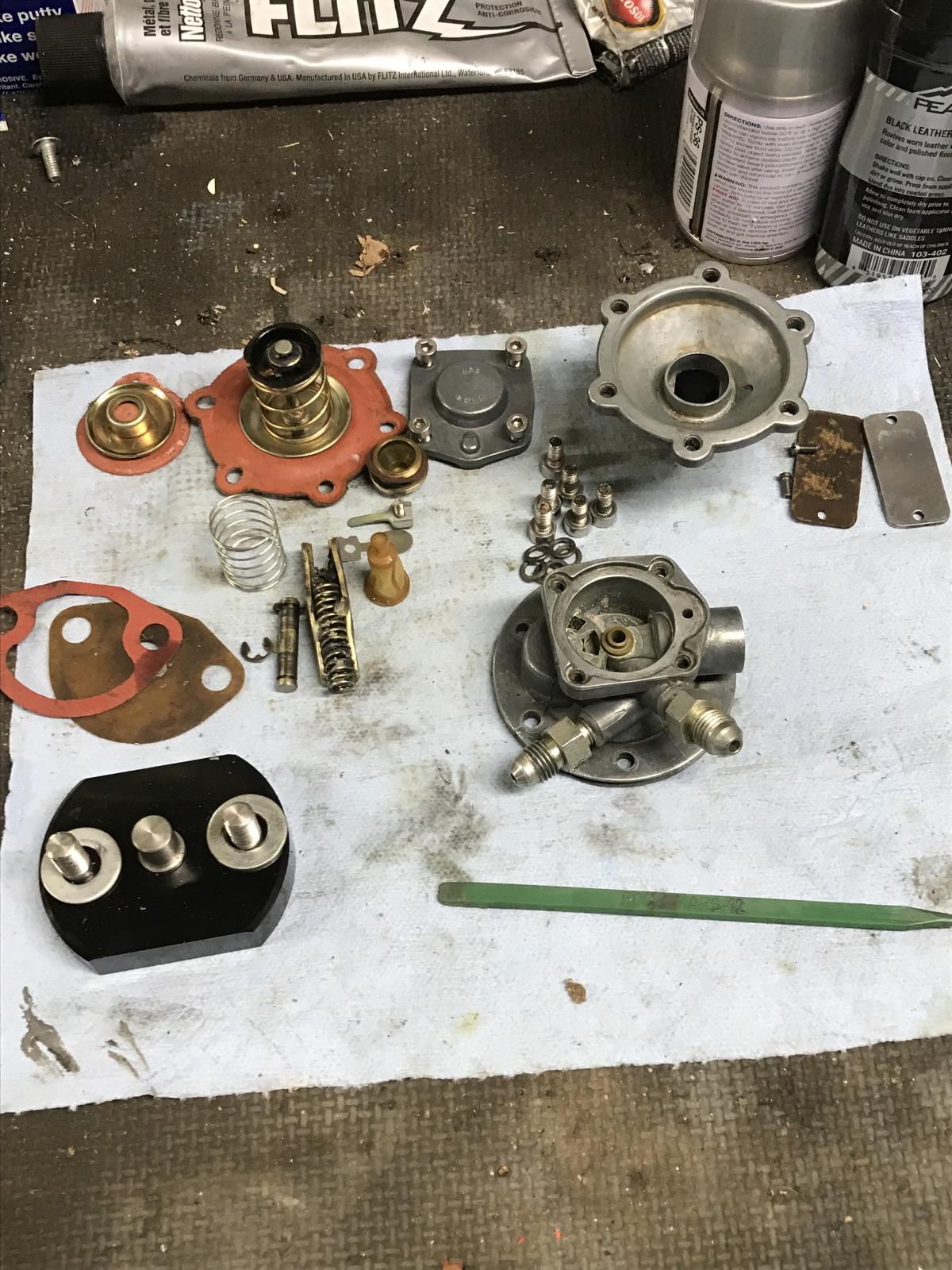

It seems that my 18 year old Odyssey battery finally decided to give up the ghost.
I’m so impressed with the performance I replaced it with the same.
PCM 1200 dry cell.
I never used a trickle charger, just a battery cut off, knever having a starting issue in all those years, even after sitting months at a time.
Unfortunately during storage last year I forgot the cut off.
The amp meter gauge drew power, killing the battery.
I put it in a charger but would only hold power for a couple of starts.

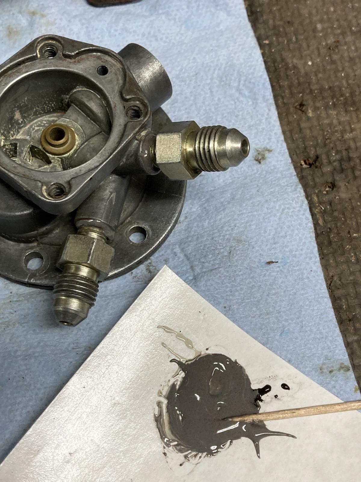

Yesterday I was planning on going to a local cruise in. Turned the key, nothing but “Idiot” lights.
I attached a jump box to the battery. Crank no start which is really unusual.
I figured I may have flooded her. No fuel smells so I pulled the outlet side of the fuel pump and had Beth crank. No fuel.
Looks like I’ll be doing a pump rebuild.
I knew I bought that preload fixture from VWNOS for a reason!

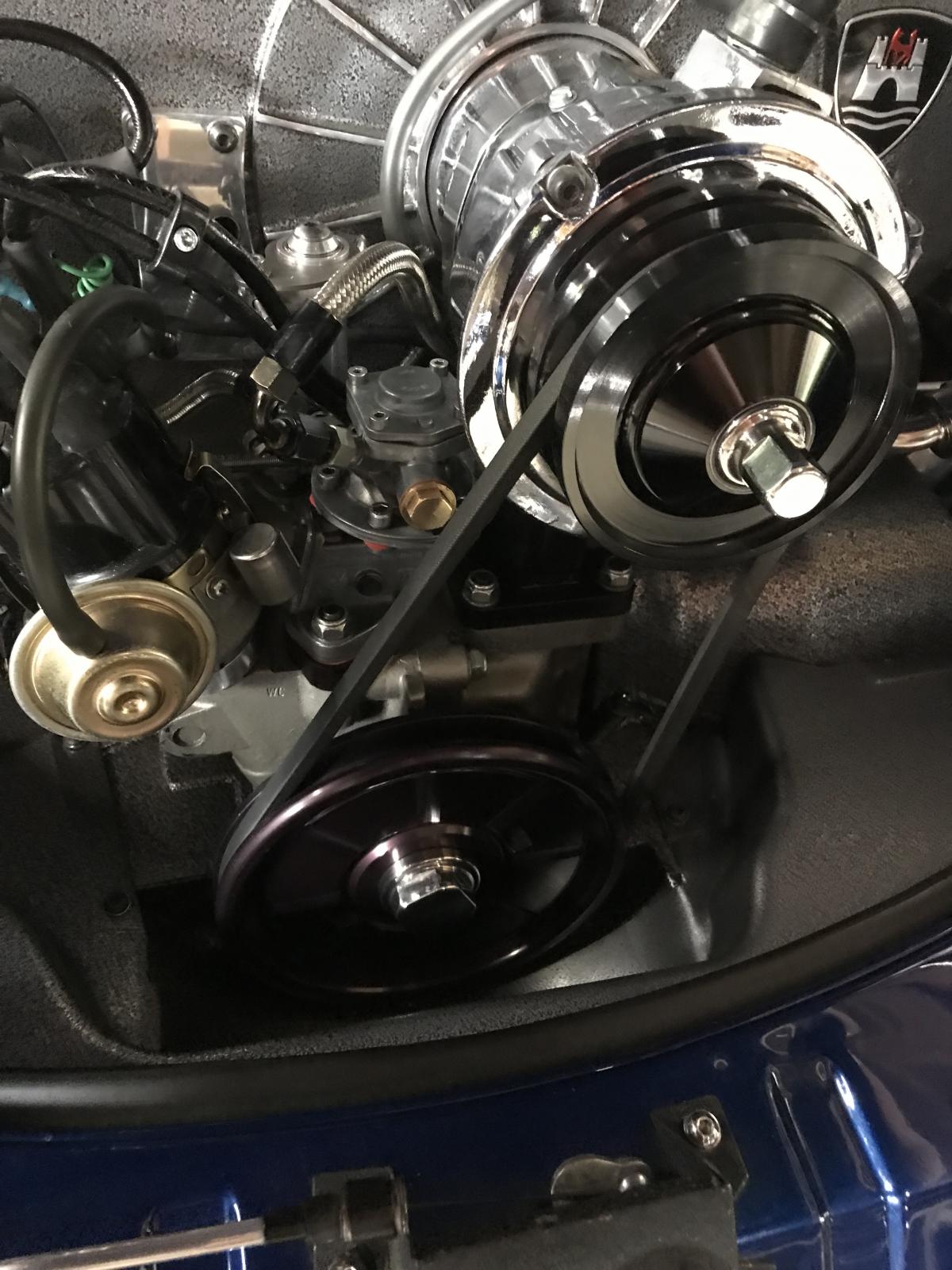

Fuel pump is rebuilt.
We are back in business! Cool

That is one of the cleanest looking engines I've seen!

Another option to cover the treads is a short piece of black shrink wrap tubing. The dandelion is cool, never saw one before.

Clean, AND beautiful!
